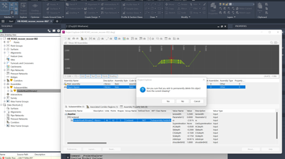

hello engineers, I have this issue of a missing subassembly part which is now not in my drawing and is causing a corridor rebuild error, it seems its a part of an assembly which doesnt exist in my drawing, Ive tried all means to delete it completely so that I dont get the corridor warnings, but its not getting deleted, Im using civil 3d 2024 and Ive also tried fixing the missing paths but its not getting solved, is there away I can delete it or or how to solve this error because my corridor is using an assembly that exist in my drawing, Ill really appreciate your response, Ive attached the screenshot plus the dwg drawing, thanks

when I try doing the fixing missing paths, I get a warning in this screenshot Ive attached, Ive also attached the assembly that Im using in this drawing, thanks again
m_kingdon
I was able to delete the subassemblies via the Project Explorer.

THANKS a million times, you saved my day, blessingssssssss!!!!!!!!!!!!!!!!!!!!!!!!!!!!!!!!!!!!!!!!!!!!!!!!
