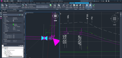

I have a drawing with pressure pipe networks that was created using parts based in 2023. Since I've updated my Civil 3D, the path based PPN ribbon is what pops up. I want to insert a GV right after the 90 bend shown in the screenshot, but when I try C3D keeps prompting to select the place to insert. I recall having to break pipes before and inserting GVs at the joint, but I can't even break the pipe. I can only break pipe runs, but this is not a pipe run. Screenshot one shows the pipe I've selected that I want to add a GV, the ribbon shown is for path based. Screenshot two shows if I disconnect my pipe from the bend and act like I'm going to extend the pipe the correct ribbon shows up, however, I still cannot add a GV. Any thoughts? This project has been on hold and I'd like to avoid having to recreate the network to make changes as we're at the tail end.

Can you go into the the Prospector and verify that there are no Pipe Runs listed under your Pressure Network?
When the Pipe is disconnected from the 90° bend, can you add a Gate Valve to the end of that Pipe?
If so, can you then select the Gate Valve and click on the + Grip and add a Pipe from there to the 90° Bend?

I do have one pipe run but it's for a hydrant assembly and would not have anything to do with this pipe. But I'm wondering if having path based and part based in the same drawing causes problems... I have disconnected the pipe from the bend and tried to add a GV but it does not work. I can click the plus and add more pipe and connect that to the bend but it won't add a GV.

This was never a pipe run. It was made part-based. The problem is it is showing the path-based ribbon. When I disconnect the pipe from the bend and click the plus the ribbon then changes to the part-based ribbon, but won't add a GV. The screenshot shows the fitting properties and one side is open so it is for sure disconnected when I attempt this.

So you have a Pipe Run in that location named Pipe Run - (6).  I can add valves in that Pipe Run.
What I'd do is detach the Pipe Run, grip edit the Alignment location to where you want to start and end the Alignment, Re-Link the Pipe Run to that revised Alignment, and last, add in the valves you want.  Yes, this will create a Pipe Run, but I believe this is the only way to achieve what you want.

I am not sure how this network was originally created.  You can create Path Based networks where you can have individual parts and add to them like you want, but your network looks like it was created using a Layout Based network, which require Pipe Runs.  You cannot mix the two though.
