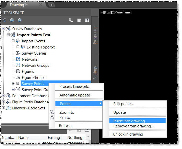

Then proceed to the Survey Points in the database tree and insert from there:
Back in the Prospector you'll see you have only one point group. . ._All Points!!!

rl_jackson
Yep. You got it. It's a really PITA IMO, but that extra point group is a bigger PITA, and I found that when I deleted the group from the drawing it also deleted the points.
You can also set up the survey database so that the points never come in on import under the DB settings, which is what I did and just always import the points after I import to the Db.
Its more or less just a change in workflow.
