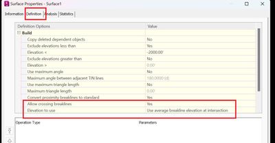

In the toolspace palette right click on the surface name and select properties and on the definition tab expand the Build category and make sure the allow crossing breaklines is set to yes. Then the option below allows you to select if you use the first, last or average elevation of the crossing lines.

I really appreciate your time.  The surface is not showing up anyway.
