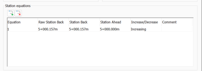

I opened a few files I have with station equations and noticed the superelevation station labels are showing the correct station:
Station equation:
Label in superelevation view
In the previous images, you can see the station equation is at 5+000, and the label 5+013.091 delivers truthful information about the station. It agrees with the one I present in the third image.
