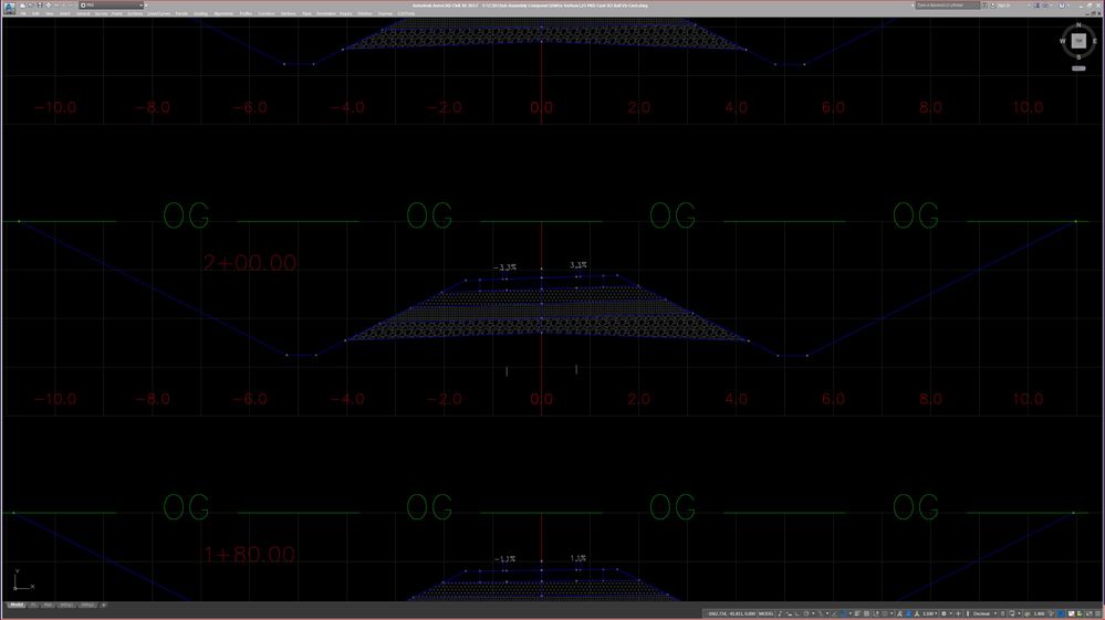

I am designing a sidewalk which is super elevated
with a normal lane width of 0.718 meter.
So thus the overall width is 1.436=2*0.718 m or imperial 56.5 inches.
In the calculate super for the sidewalk alignment i set the normal lane width
to 0.718m and normal lane slop at 0.00% and a walking speed of
50 Kmh or 31 mph to populate the super elevation table for this
class 1 sidewalk.
Note: Low side Pivot is on inside curve of sidewalk.
So i am having a difficult time getting the low side sidewalk to be
at elevation 99.00 O/S 0.718 from CL.

Note at end of support timbers is the elevation 99.0 inside curve.

Figured it out planar roads need a lane "width" parameter
Note not all Stock subassemblys support a "Lane" ie have one,
for planar to work you have to have subassembly with a lane width
so C3D can use the "lanewidth" for planar roads.
So if building a planar road look to a
SAC built see Subassembly.PKS_Right_Side_Rail_Complete
Note not all Stock subassembly support a "Lane" or have one
So in SAC make a Parameter with Width much like
Subassembly.LaneSuperelevationAOR
which makes a nice planar road.
So in SAC make a Parameter with Width much like stock
which makes a nice planar road because it has a lane "width"
Please review updated 2017 C3D Dwg note low rail position at 99.00 FG top rail
Pete
Note low rail is good at elev 99_0.JPGRequire lane in SAC and Yes Potential pivot.JPG
