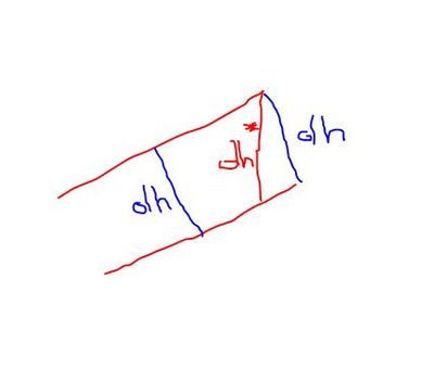

While this is much better, it's not 100% correct (depending on what you want, of course).
When you enter "extrem" values for the slope parameter, you can see it:
With zero% slope, the angle is 45° which is correct:
With something unrealistic like -75% slope, the angle turns into this:
Unfortunately, Autodesk doesn't give any love to the SAC. Tools that would be really good in situations like this (like "offset geometry") aren't dynamic so you have go back to doing a lot of trigonometry.
For example:
In the first pkt that was posted in this thread, P3 was created as an deltaX and deltaY which is not correct.
It has to be adjusted with a trigonometric function to calculate the real value.
Your depth-value is dh while the real distance is dh*.
I don't have a lot of time so I only found a rather messy example I once made.
It's not too clean (and in german) but it maybe stirs you in the right direction.
If there's an easier way, I'd be happy to know!

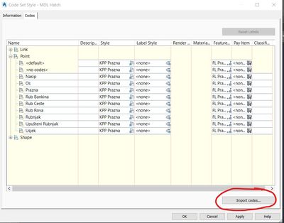

Thank you All ,I created that file with out error  .One issue still remain,I cant edit the code style ,Please help.

you edit codes from code set style and then you import your codes in your style (select your subassemblies), or add them manualy (right click on link, point or shape and add)
code set stylescode set stylesimport codesimport codes
Message 17 of 17
surajpanayath
Thank you,Right solution
