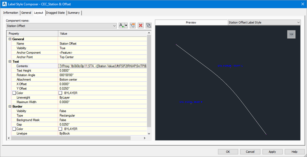

Here's the style box with the original label that was created in C3D 2017.  At the beginning of the "Contents" line, it begins with "STA."
Here's the same style box with a modified label.  The only thing that was done to the label style was to add a return at the end of the label.  The beginning of the "Contents" line includes "\fProxy1..."
Is there any way to edit this to remove the "Proxy" designation?

Undesired Font StyleUndesired Font StyleFont override 'Arial Unicode MS'Font override 'Arial Unicode MS'
