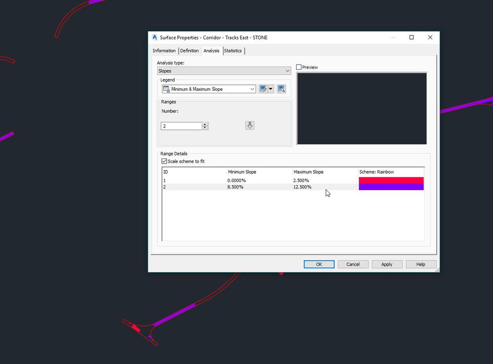

Can anyone shed any light on why I can only get 2 Slope ranges in my analysis - even when 6 are chosen?

check the surface style, under analysis tab>slopes>group by. yours might be set to equal interval, change to quantile and run analysis again.
neilyj666
Perfect solution - that was indeed the problem....:)

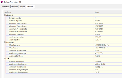

getting this same issue in 2020, 2022, 2023 and 2024. it is repeatable. something is broken. i can see the analyzing date box flash then then it stops. any one else having this issue.
Udo_Huebner
If the terrain consists of only a few and very flat triangles, it may not be possible to create as many ranges as entered. In this case, first check the surface statistics or post the DWG here.

Thanks for the fast response.
I am able to create a new style and to get it to work, but I can't see any difference in the 2 surface styles. I tested your theory on the limited triangles on a test surface and was able to produce the error as you have stated. this surface has a lot of triangles. I'm wondering if the surface style is corrupt.
