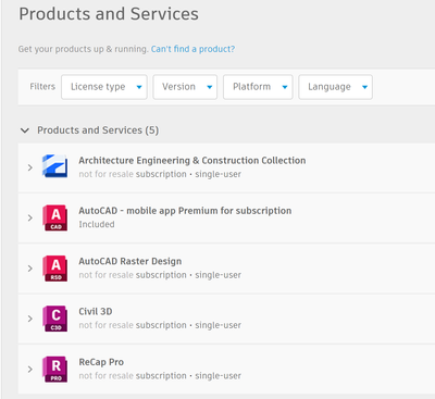

AllenJessup
@Pointdump
What does you account page say?
Allen Jessup
CAD Manager - Designer
Message 6 of 11
Pointdump
Hi Allen,
I guess it's available to me, but I've never installed it.
Dave
Dave Stoll
Las Vegas, Nevada
NVIDIA Quadro P5000 16GB
Message 7 of 11
Pointdump
I've only ever installed "Standalone" Civil 3D. Right now I have 2022 and 2023.
