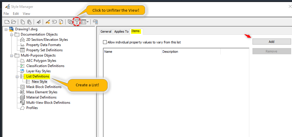

Hi @Valentin_Belets
You can do something similar to a lookup by creating a List definition first (to compose a list of items) and
then reference that list as the source for the property set attribute.

rl_jackson
@samir.rezk
I created a lookup/list that has multiple values in each list to define various items, as shown below.
However, when I go to my point label style to apply the items that are part of the list within the label style they don't appear in the selection list, is there something I'm missing or does this function not exist.
Thanks, Rick

Hi @rl_jackson
List definitions do not show up in the drop down menu in the label style composer automatically, however we are able to write the label code directly. type the following:
<[PSD Name:PS Name(CP)]>
Based on your screenshot, an example will look like:
<[Structures:A_Direction(CP)]>
CP means case preserved, this can be changed to CU or CL
same code applies for creating table styles!
Hope this helps,
Samir Rezk
Technical Support Specialist
