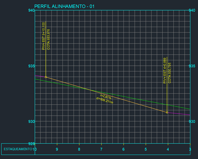

This works well when the profile view direction is left->right. If the profile view direction is from right->left then the labels outside of the view are dropped. Is there a setting needing to be changed for right->left profile views, or something else that can be done to get the view labels back?
Profile view reading left->right
Profile view reading right->left, grade on left and right segments are missing

The label is supposed to be attached to a line.  Start by checking to see if the lines exist.  In the label style make the line visible.
Steve
Expert Elite Alumnus
Matheus-Lima
Hey @jbokic2F9MM. I created a similar style with the same parameters and got the same error with the Right to Left profile view. I turned on the line component as @sboon suggested, it's the yellow line. The purple one is my profile.
Solved it by using Anchor PVI Start/End in View.
Not sure why this happens, but I think is related to how Civil 3D understands what is "up" and what is "down" when you use Right to Left profile views: https://forums.autodesk.com/t5/civil-3d-forum/odd-label-behavior-in-right-to-left-profile/td-p/93844....

jbokic2F9MM
Brilliant, thank you @Matheus-Lima !
