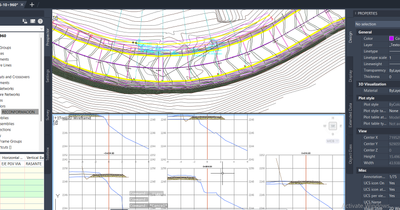

Hi , i have problem , when i project corridor in other sections  , some section appear moved.
I create a aligment for road , so i need to create a wall ( i create other aligment for wall) , however when i project , appear moved. I attacha file , maybe you could help me.

Hi guys! I did not see the file either. However, I wanted to tell my what guess is from that post
I guess that @lbenavidesmDCQ4S created a perfectly curved alignment for the wall but the corridor beside it looks jagged. Additionally, he might be cutting cross sections (placing sample lines and creating section views) at locations where the corridor has not assembly insertions. This combined situation might be fostering an awkward appearance.
What he could do is to add a manual section to those required corridor stations between which the retention wall will be placed. Adding these to the stations where the sample lines where placed would also help.
You can alternatively increase the frequency of the whole corridor. However, this would increase the overall size your file as well.

In addition to ecfernandez  solution, I would suggest to use close frequency on curves. It will give more accurate corridor/design. You can tweak the corridor frequency at curve from the highlighted options.
Usually you can use close interval than tangent. For eg. if along tangents 10m we can go for 5m in curves

I had a quick to your file and i think your file ok.
When you say moved corridor, do you mean the corridor is on the left side of the red vertical line in the section views?
This should be like this, because this section view group refers to sample line group that refers to the Alignment EJE BOLSACRETO 01 (the yellow one).
This alignment is falling outside of your corridor. The corridor RECONFORMACION is on the left side of the alignment exactly as the section views showing.
See my attachment, is this is what expecting to see?
