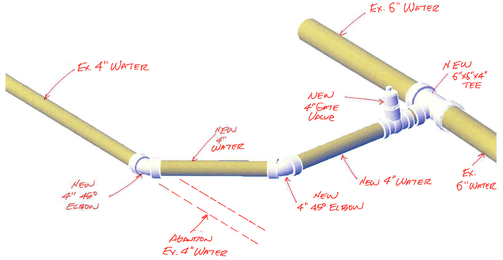

Mark_Castle
My approach is to use pressure pipes for as much as you can without driving yourself crazy, and then supplement with manual methods.

using pressure network on production of plan and profiles is completely worth because as @Mark_Castle shown on sketch its easy to use and show the information and also if we use the pressure network tool we can also do clash detection and analysis in navisworks manage another advantage.
All we need to do is setup the template file first for appearance of water line, fittings and valves. once we have setup we should fine a proper work around to execute the same. i always keep proposed network and existing networks or onsite and off site pipes in different files and also other utilities such as storm drainage, sewer and any other utilities in different file. for final sheet file i use data shortcut methods to show on plan view and profile view and also to annotate the same. for crossing of utilities also it very easy to show them on plan view and profile view.
There are options available to break the pipes, add the pipes, fittings and contention work on profile view and plan view (attached the same) which made designers life easy to work once he/she know how to use.
