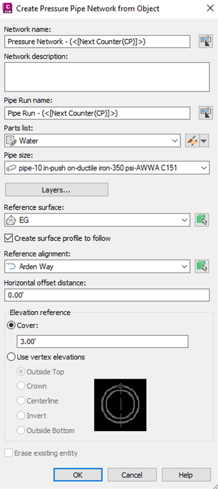

I need help figuring out why my pressure networks are auto-following a profile that follows top of pipe rather than centerline? When creating a pipe run profile it will generate the profile sitting at the top of pipe. I think this is the C3D default, but everything I'm understanding is that the parametric models used by pressure networks have connection/insertion points along the pipe/fitting centerline. Is there a setting to get this auto-generated profile to follow the centerlines? We have many projects with different sizes of pipes and when the profile is forcing the network to snap to top of pipe our tie-ins and areas where pipe sizing changes get really funky, rotating our tees and reducers vertically to try and solve the path.

The profile is the top of the pipe because that is the way the program was designed to work.  Fittings and appurtenances utilize their center for their elevation coordinates, but when placed in a pipe run, their top is automatically calculated so they are placed in the proper vertical location.  When tying various pipe sizes together, you have to account for this in your profile elevation for the branches coming into the main line.   I agree, that it would be helpful if you could specify what line you wanted to use for the design profile.  The majority of the time, the top of pipe is the most helpful, because we're concerned about the amount of cover on the line.  When we do pipes together, being able to specify the centerline would be helpful, or tying into various process pipes, as they tend to provide their data using the center of the pipe as well.   I would recommend visiting the Civil 3D Ideas forum and if it isnt an idea already, adding it.
