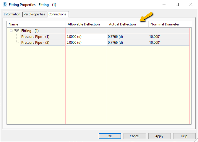

Civil 3D 2022.  I laid out a pressure system with pipes only, using the allowable deflection I set up.  Is there a way to go back and look at a pipe and see what the actual deflection is?

Hi @KarlHanson
Yes! select any Pressure Part (pipe, fitting or appurtenance), then right-click and go to the Part Properties dialog > Connections tab
Hope this helps,
Samir Rezk
Technical Support Specialist
