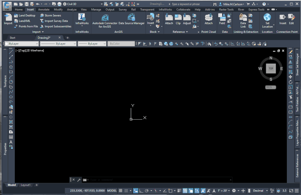

This could be a units issue related to the coordinate system you selected.  ReCAP will output a .rcp file in metric, so you need to make sure you set the following settings in C3D before attaching the point cloud to ensure metric units are converted to US Survey Feet or International feet.  Please see short animated video below of an example scenario: POINT CLOUD ATTACH.gif
Note how there are two places to ensure the correct metric to imperial conversion (C3D Settings: Units\Zone Tab and ACAD units.)  Make sure you see the metric conversion scale factor being applied upon point cloud insert.  I hope this helps.
