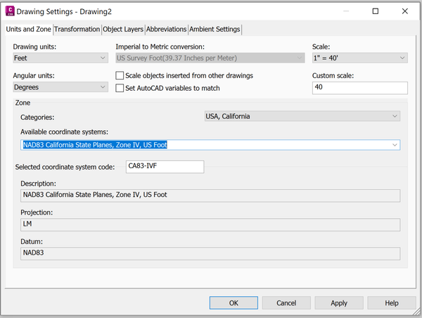

There is more than one way to do this. Here's one way:
1. In Excel multiply the Elevation Column by 3.28084 to convert it to feet.
2. In Civil 3D use an Imperial Template and assign CA83-IVF Coordinate System.
3. Create a custom Point File Format to recognize the Lat,Long,Ft CSV file.
4. Create a Surface and add the CSV to the Surface Definition.
Drawing attached.
