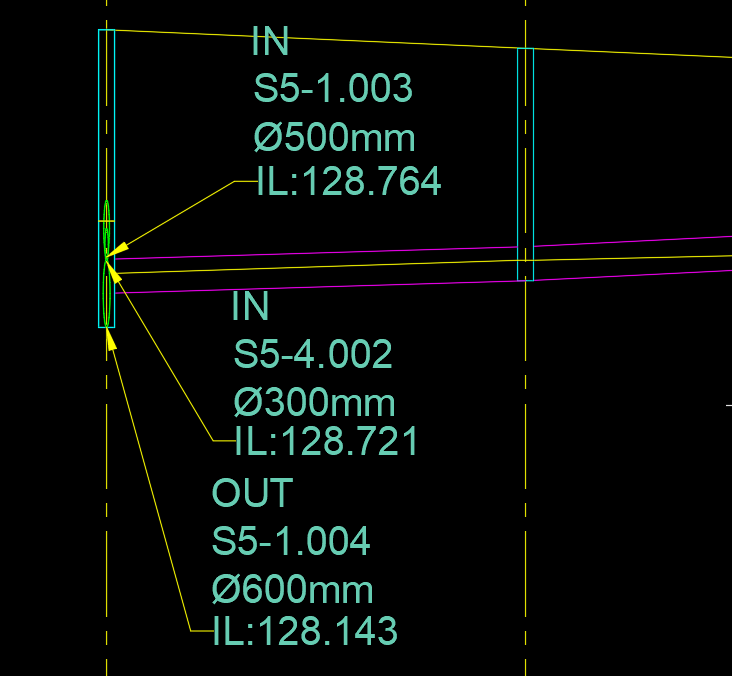

I am working with a sanitary pipe network.
While creating the profile, how to label the connected pipe name and invert level?
Please advise.
Attached screen photo.
Thank you

Sinoj.Ravindran
@samir_rezk
Actually, using text for each under structure will give in and out pipe details, but it wont pointing the arrow leader to that pipes exactly, instead it points to the structure..
Is there is a way to point also the leader to that pipe exactly?

Sinoj.Ravindran
Hi Samir,
Please see attached the image as per your request..
Note that I have one pipe incoming ( excluded the main pipe which shows in the profile, but incoming pipe labels always label that also) and one outgoing. I have created two label style- one for incoming pipes and another for outgoing pipes. But, what happens is showed in the image attached. The arrow head leader always pointing towards the structure, not to the respective pipes in and out. So I need to manually explode the labels and move the arrow head to the respective pipes each time. This wont update automatically when a revision happens to the pipe network, I need to do the same procedure again as I exploded the labels, loses dynamic nature.
Hope you get what I am looking for..

Sinoj.Ravindran
Hi Samir... Thank you so much for your time and I have watched the video.
I am searching for something not to label the main pipe which shows in the profile.
It is the incoming and out going pipe from manhole which need label with Pipe name and invert levels.
If we use text for each it works, but the leader arrow head doesn't point towards that particular pipe in / out, instead it points towards the manhole only.
I need to explode the label and then point the leader head towards that in/out pipe. Which wont update dynamically next time revision is done, as dynamic ability is lost while exploding.
Please see attached picture, where I have clearly shown the pipe inside manhole.

Sinoj.Ravindran
Hi Sam..
I have learned with the help of you upto that point of labelling the structure in and out pipes..
Now, what need is to exactly point the in and out pipe as shown in the attached picture, which I have made by exploding the labels and then pointing the leader to the respective pipes.
Please have a look at it.
