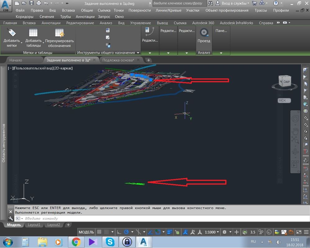

Hello! PI of the feature line is displayed at the zero elevation. Are there any settings that I can change to display on the surface?

I'm sorry, my English not so good and I don't know  many definitions in English, because translating them into Russian is not verbatim. But I'll try to explain and attach the drawing file.
This situation with all feature lines, the style of labels is the main one (standard?), I hope that correctly translated the name of the style. But in the style of labels there is a round marker, and a triangular problem, the style of which I could not find in the settings.

I am having trouble identifying a labeling problem with your feature lines. I was able to add feature line labels to your feature lines and the labels are created at the proper elevations.
Maybe you can re-upload your drawing, but with a feature line and its labels isolated. That will help me figure this out.

Hello! This is more photos

I am getting the same result. The workaround would be to build a label style which includes a block to replicate the look of the marker.

Thank you so much! But how can I do it?

I rescind my answer. You're not trying to label, you're having issues with the glyphs that display during Edit Elevations function.
I don't have a workaround other than to do this editing in plan view.

Ok! Now I at least know that this does not change. Thank you anyway!
