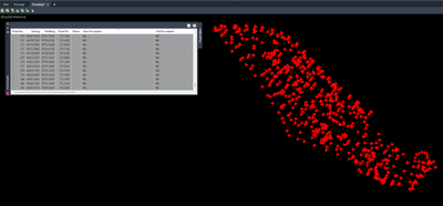

It looks like your original .csv just had Northing, Easting and Elevation and I got the same error message when trying to import.  After opening the .csv and editing it to include a Points column (numbered) and a Description column (NG), I was able to bring it into C3D:
Take a look at the modified .csv and see if you can import that using the PNEZD comma separate format
