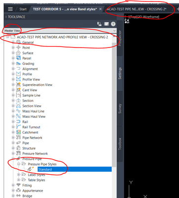

Hi @soonhui,
As an alternative to the import you could try dragging and dropping via the settings. If you open both the source and destination drawings. Inside the destination DWG, goto Settings (ensure you have Master View selected), Pipe Network, Parts list, of the source drawing file. And drag and drop the Parts List from the source DWG into the model space of the destination DWG.

@ianjchap , I'm talking about Parts List under Pipe Network that has the problem, but you are showing Pressure Pipe Styles.
They are very different... do I miss anything?

ianjchap
Good point, I read your last sentence and picked up on Pressure Parts list.
However, the same procedure applies to the Pipe Network Parts list:-

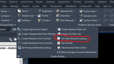

ianjchap
Also, ensure you have the correct Pipe Network Catalog set:-

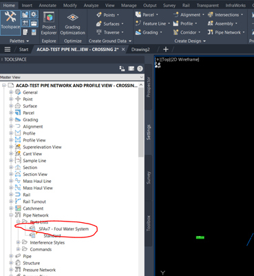

I've done this from a clean DWG holding the parts list _sfav7.....
With the two DWG's open, I goto the destination file and open the settings of the source DWG, in my case Drawing2, then Pipe Networks, Parts List and drag the _sfav7 parts list into the drawing. If I then check the parts list of the destination drawing, in my case ACAD-TEst..  I can see the Parts list has copied across. I'll try to produce a quick video clip of the workflow also.

@ianjchap , thank you for your help! It appears that under ToolSpace->Settings I need to set to the Master View before I can copy that specific styles ( and not all styles) from one drawing to another.
But the million dollar question now is, why Pressure Pipe Network Style doesn't have this problem?
