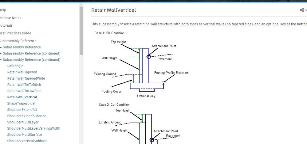

fcernst
That's exactly what RetainWallVertical does..

ndegan
Hi Fred,
Yes, the default retaining wall subassemblies will taper if the corridor is targeting EG and goes from a section of fill to no fill.
The situation I am looking at is entirely fill. The example I gave is a trail that is 5' of fill above EG along its entire length, with regions that have 3:1 grading and regions that have retaining walls. I am looking for a way to easily transition the retaining wall up to meet the 3:1 grading. Left as is, they dead-end and the wall is left at 5' tall. I want to taper the wall from 5' tall (where is connects to EG) up to the point where the 3:1 region is.

fcernst
If your target surface (EG) is not doing the the 3:1 slope you show in the picture, then you have to create a modified EG that does.

fcernst
I don't want to modify the EG in order to make the taper...
 "EG" is just whatever target surface the RetWall subassembly targets... So just create a surface like the picture shows and run the subassembly through it.

fcernst
 It sounds like you want the continuous intersection between the vertical and a 3:1 slope projected up form EG.
You could use LinkSlopesBetweenPoints for this.
Then take this slope intersection concept to SAC and create a wall with thickness and Shape.
