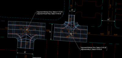

Working through modeling the corridors for a subdivision with three different section widths. I'm having the most trouble in areas where I am more specifically modeling the intersection between a 60' corridor, and a 22' corridor.
Where the pavement widths and right of way widths are different, it is not modeling these accurately as the right of way is not a direct offset of the curb return (see photo below)
Is there a way to model this intersection in a way that allows the fillet at the right of way to taper with the changing corridor width? Or something to change potentially in the curb return fillets assembly that would allow this?

Yes, there is. Take a look at Corridor Transitions. If you select the Corridor, it will be on the ribbon, or you can type_EDITCORRIDORTRANSITION.

Thanks for reaching out to the forum. Tim is right about Corridor Transitions. If you're not familiar with how to use them, I recommend checking out these two videos by our Civil 3D expert, Jeff Bartel. He explains the process step-by-step:

Thank you so much! This solved the issues I was having with those areas! And thank you for the video references! I will use them to help me practice! They can definitely be a little tricky to get used to!
