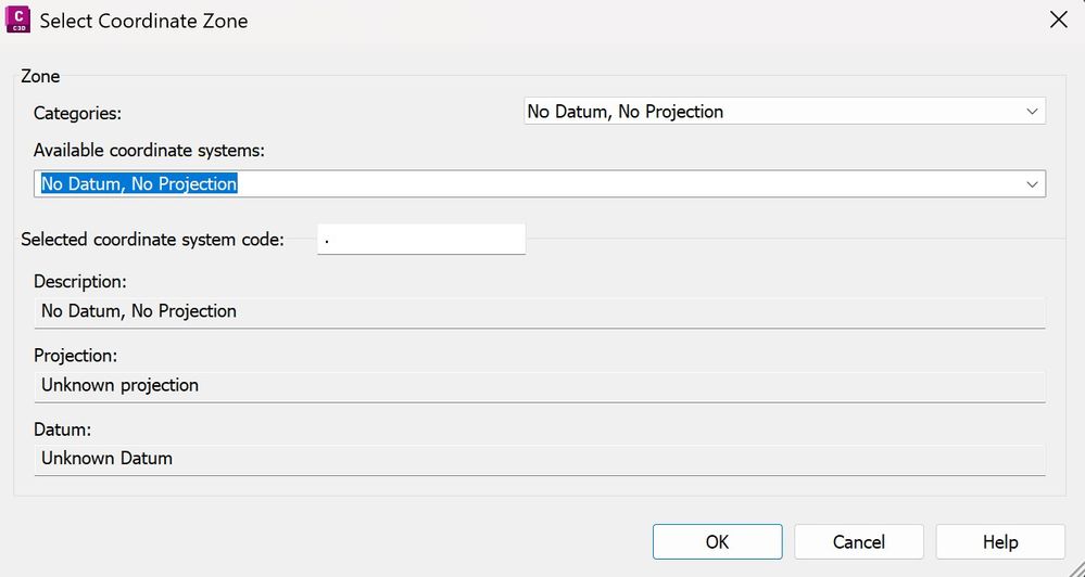

So I have 2 identical (or so i thought) installations of Civil3d 2025 on separate computers. I am working on a process to import DEM data and add it to a surface. On the computer where it is working as intended i get a different dialogue than on the computer that is not working as intended

On the other computer with the same 2025 civil3d install it is not working as intended and i get a different dialogue as shown:
As you can see its totally different where it has the DEM File as a whole rather than broken down by northing easting and then elevation, and also a different select coordinate system dialogue. Anyone aware of what setting I am missing or what is going on? Any help would be appreciated!

Pointdump
Pete,
I get the second dialogue box--"Select Coordinate Zone", and I usually type in the CRS at "Selected coordinate system code:"
The first dialogue box looks like the coordinate system was assigned using command GEOGRAPHICLOCATION. In that drawing, use command GEOREMOVE and re-assign the coordinate system using command MAPCSASSIGN.

psteenland
I try using the second one, it brings in a surface but its completely off where it should be and is scaled incorrectly, so there is a coordinate system issue. I just dont know why the second computer has a completely different way of importing the file than the first computer which is working perfectly fine with all the dialogues.

ChicagoLooper
@psteenland
wrote
<<... yes, i have it preset in our organizations template file, so everytime they create a new drawing they are all using the same coordinate system...>>
Your preset is not being applied--it's being ignored. You can resolve the issue by manually assigning a coordinate system.
also wrote
<<...the second one, it brings in a surface but its completely off where it should be and is scaled incorrectly,...>>
What happens when Aerial imagery is turned ON? Is the imagery consistent with your surface? BTW, a basemap with imagery can only be turned on if you've properly assigned a CS in the first place.
If the background image is good, great. But if it's inaccurate (and you've accurately established the coordinate system), then image is accurate and your surface is in the wrong spot.
