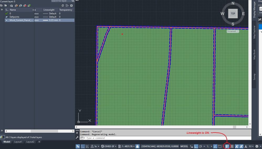

ChicagoLooper
Have you tried using the Data Connect Palette?
I added your shapefle using the a Data Connection. I didn't use the Drag-N-Drop method. See blue line work below.
I also 'imported' the same shapefile using MapImport command. Refer to dashed red lines. The shapefile line work and the imported line work fall on top of one another.
The assigned CS used in modelspace is OH83-SF (EPSG 3735). Didn't have to close down and reopen the drawing.

Message 17 of 42
ChicagoLooper
@sfore wrote:
<<....The shift is miniscule, so if your lineweights are on, you won't see it....>
Line weight ON.
Image-1.Image-1.
Line weight OFF.
Image-2.Image-2.
I can easily perform this  experiment using two circles each with a different radius.
  1. Turn OFF polylines  from MapImport so only the shapefile remains.
  2. Using osnap, draw a circle with centerpoint at the shapefile's corner. Write down the circle's center point.
  3. Turn OFF shapefile and turn OFF circle. Turn ON polylines from MapImport.
  4. Using osnap, draw a second circle with centerpoint at the polyline's corner. Write down circle's centerpoint.
  5. Compare coordinates of both centerpoints.
Image-3.Image-3.
Image-4.Image-4.
Sorry, but this experiment using plain vanilla AutoCad commands reveals my drawing using your shapefile has no shift.
