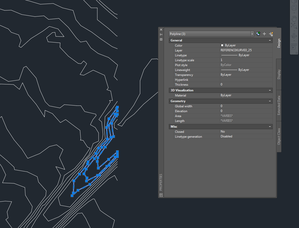

Hi
Followings happens:
I import GIS contours as shapefile, where the elevation is shown as attribute.
After the import, some polylines are missing their attribute?
I have checked the GIS contours through data connection, (SHP) and i can see all the attributes.
I have tried to import the shapefile several times, and it appears to be random each times which polylines that have no attributes
What can it be?

I don't have shapefile data to test at the moment, so this is all from memory.
When importing a shapefile, there should be an option to place the line at elevation defined by attribute, then you select what  attribute sets the elevation.
The properties your looking at are the geometric properties of the line, what elevation the line physically sits at.
when you import a shapefile with attributes, I THINK, the attributes that come with it are displayed on one of the other tabs of the properties window (Extended Data maybe.)
So, if you poke around the other tabs, and find the elevation attribute with the correct data, but don't have the lines sitting at the right elevation in space, I'd look for the import at elevation option on the import dialog.
Now, if this WAS the answer, I'd expect all contours to come in at 0 elevation. If the data was imported correctly, no idea why only some would be at the proper elevation.

@jmayo-EE I have used the same work flow,
But the problem it is when i import the shapefiles with the data, not all the attributes comes along wtih the polylines.
i have uploaded the files, maybe you could try.

OK. Now I need to know which Data Field contains the elevation. Looking at them I thought only HOEJDE made sense. But when I query the area within the rectangle defined in your drawing. Every contour has an elevation.
Allen Jessup
CAD Manager - Designer
Message 18 of 22
tcorey
I imported your shp file using MapImport (in Civil 3D 2018). I wrote the following code to find any polylines that do not have HOEJDE (elevation) attribute. None were found. This routine also moves your polylines to the elevation captured from the HOEDJE attribute value. You can change the _Tims layer name in the code to whatever you want, but be sure the layer exists before you run the code.
