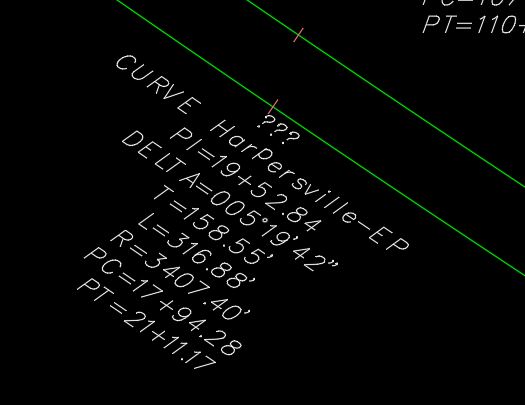

Our local DOT requires to list alignment curve data in a non table format, Could you please advise how I can generate a report as shown in attachment. Thank you so much

This can be accomplished with a standard label where the drag state arrow is turned off. You just need to set up the style to reflect how you want it to appear in the drawing.

I was able to generate the Curve listing, thank you for that, but there is one question I am getting "???" on top line which we intend to assign a tag for the curve, would you mind please advise how to address this issue, thank you so much, please see attached.

Check your style for the following.
On the layout tab under the Table Tag component verify that Visibility = True.
I believe that if you want to show the data along the line or arc and show both simultaneously you will need to set the Used in just below it to Tag and Label Mode as this will show both the label and tag #.

Visibility is set to True, also I have attached the curve components in the text format which I have for the label

Yes but to get both you need to have set the Component - Table Tage so that it5 is USED IN Label & Tag Modes,REMOVE and the Tag Component from the Distance & Radius Component. This makes both labels appear.
