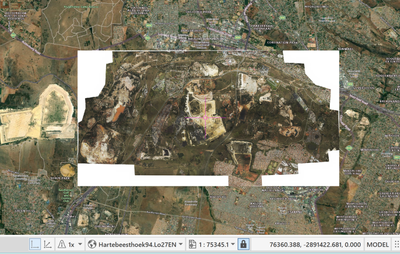

Hi
I've converted a ECW file to a RCP file so I can import it into Civil 3d, but when I import the file the site coordinates place the site in Antartica. The Lidar scan was done over an area over the Witwatersrand in South Africa.
I can't figure out what I'm doing wrong in the conversion on Recap or could it be the why that I'm setting up my Civil 3D file before I attach the survey to the drawing.
If anybody has had a similar problem and found a solution, please help.

Hello @jsaayman
You'll need to specify the ecw's native coordinate system in Recap. The native coordinate system of the ecw was given to the ecw by the original author so you need to accurately determine what it is--no guessing is allowed. Then you'll need to assign a coordinate system to the modelspace of your drawing.
If you assign the same coordinate system to modelspace as the ecw, you'll be fine.
However, if you decide you want to use a DIFFERENT coordinate system than the ecw then you'll need to perform a transformation so AutoCAD can transform the ecw's CS to your modelspace's CS.
The fastest and easiest way to resolve your issue is to upload your file (or provide the a downloadable link) so the forum can evaluate the ecw. Also, do you know what coordinate system you would like to use for Witwatersrand?

The Survey system that the ECW file was done on was the WGS84 Hartbeeshoek 94 reference.
Message 6 of 10
Pointdump
Juan-Emil,
While waiting for ReCap to process that large LAZ file, I drag-n-dropped the ECW into QGIS. QGIS shows EPSG:2052, and then drops it into the sands of Egypt.
OK, ReCap finished processing the cloud, using Hartebeesthoek94.Lo27 (EPSG:2052) and Civil 3D also places it in Egypt.
At this point we're just guessing what coordinate system to use. I'll check ESRI:102566 Hartebeesthoek94 Lo27 (E-N), but I really think you'll want to make a phone call to verify exactly the coordinate system. Try to get an EPSG or ESRI number or WKT file if it's a custom coordinate system.

OK, I figured it out. Both Point Cloud and ECW Image are in ESRI:102566 Hartebeesthoek94 Lo27 (E-N) Coordinate System. Unfortunately that CS is not in MAPCSLIBRARY. Normally it's a quick add, but South African Coordinate Systems are quirky. I'll play with it.

ChicagoLooper
Hi @jsaayman and @Pointdump
Both the ECW image and the LAZ points were evaluated in Global Mapper. The projection used in Global Mapper was UTM84-35S, meters.
LAZ points:
The points are projected to Transverse Mercator, Hartebeesthoek 1994 datum with NORTH orientation, meters.
ECW imagery:
The image is projected to Transverse Mercator, Hartebeesthoek 1994 datum with SOUTH orientation, meters. The south orientation is the issue and needs to be changed. See image-1.
Image-1. Global Mapper has both North and South orientations of the Transverse Mercator.Image-1. Global Mapper has both North and South orientations of the Transverse Mercator.
When the ECW's projection is changed from south to north the ECW inserts correctly. See image-2.
Image-2. Note: World Imagery is shown in the background for reference.Image-2. Note: World Imagery is shown in the background for reference.
The LAZ point cloud is projected correctly. It's using Transverse Mercator, Hartebeesthoek 1994 (north orientation), meters or EPSG 2052. No modifications to the projection are needed so it inserts correctly against GloMap's UTM84-35S coord assignment. Once the ECW's projection is corrected, it can be inserted along with the LAZ points. See image-3.
Image-3. Both the ECW image and LAZ point are inserted . the background is world Imagery.Image-3. Both the ECW image and LAZ point are inserted . the background is world Imagery.

Pointdump
Juan-Emil,
Here you go. Custom Coordinate System created. >>>ESRI:102566 Hartebeesthoek94 Lo27 (E-N)<<<. Use Command MAPCSLIBRARYIMPORT to import the new CS into your MAPCSLIBRARY. ReCap draws its Coordinate Systems off of MAPCSLIBRARY, so you can use both the ECW and the LAZ files in Civil 3D.
