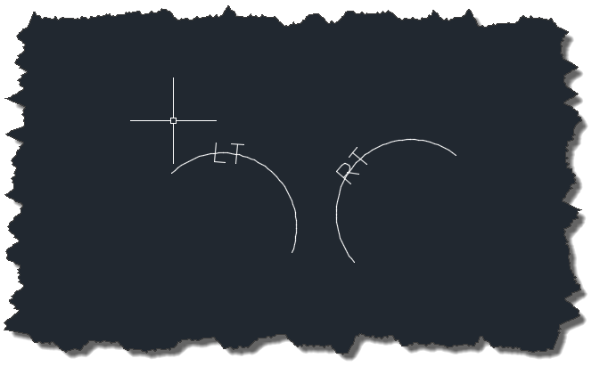

Hi there,
I'd like to return LT for left direction curve or RT for right direction curve in a curve label style.
Can anybody help me with a formula for an expression to determine whether a curve is left or right direction curve?

Hi Andrew,
Try this:

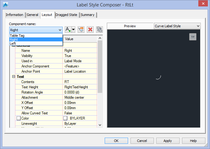

  1. Create 2 expressions for the curve label styles:  one for the 'right' label text component height, and one for left.  Expressions are based on the curve start direction - curve end direction.  note that you *may* need to adjust the equation to account for certain values for the directions (or use additional expressions?).
    Note that the value of '0.00254' corresponds with an intended text height of 2.54mm for this example.
  2. Next, create a 'Left' and a 'Right' text component in your label style...use the same anchor point, etc for each and set the text height to the appropriate expression (created in the previous step):
  3. Test on a couple of curves to validate the results:

There are General Segment Start Direction, General Segment End Direction, and Curve Chord Direction fields, however, these return azimuths or bearings depending on settings; there is also a General Segment Total Angle value that always returned a positive angle value when i tested it... The first two fields are the ones you must therefore use to calculate a signed delta value (unless I'm missing something here?), which may then be used to determine whether the curvature is oriented to the 'right' or to the 'left'.  Because we cannot generate text values in expressions, we must add text components for both options to the curve label style and use the expressions to control text height...
