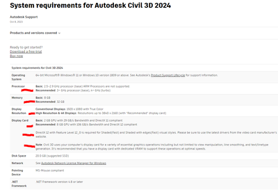

ChrisRS
Good timing!
AutoCAD 2024 was released today. (March 28, 2023)
Memory - Basic: 8 GB, Recommended: 32 GB,  Display Card  - Basic: 2 GB, Recommended: 8 GB)
(For reference 2023 = Memory - Basic: 8 GB, Recommended: 16 GB,  Display Card  - Basic: 1GB, Recommended: 4 GB)
Civil 3D 2023 was released on April 12, 2022 with the same 8/16 and 1/4 requirements as AutoCAD 2023.
It is reasonable to expect C3D 2024 to be released in a similar time frame.
Edit: This morning (March 29, 2023) I received an invitation regarding an April, 18, 2023 presentation:
Link -
What’s New for Civil 3D, InfraWorks, and ReCap Pro
Presumably, C3D will be released prior to April 18.
System Requirements Link:  https://forums.autodesk.com/t5/forums/replypage/board-id/66/message-id/489440
