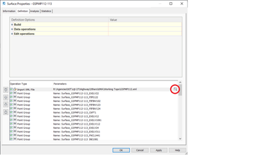

You should be changing the path in the surface definition to the new xml file. You should not need to re-create the surface. See the image below. Find your xml operation, scroll over and click the folder. Go get the new file.
This sounds simple enough to follow. I will try this. Looks very promising
This works, i just need to rename the file to match the original name that i use on the very first time i imported the XML
