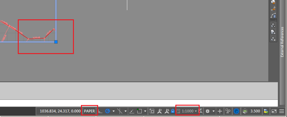

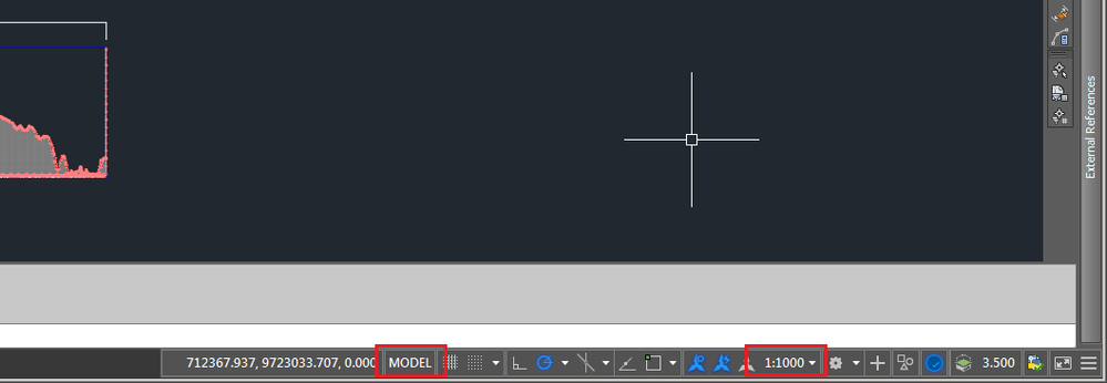

I have my profiles and layout with image in the model space, with scales and annotation that i want. But, when i want to use them in paper space all of the texts are suddenly too big. Kindly help me solve this.
I have read your response but still doesn't work,it's either I don't understand it well or something is still wrong.please help me find a solution for this.
Attached is the dwg file i am working on.
Best regards,
Fabrice
akaufmanJR3FV
Hello Fabrice,
While I am definitely not the most experienced with this stuff, this is what helped me when I was having the issue that caused me to create this thread:
In your Model space, you have your scale set to 1:1000, which is what you said you want your scale to be.

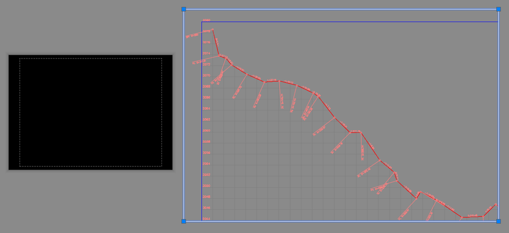

In Paper space, make sure that your viewport has the same annotation scale as your Model space. From there, you have to size your viewport to accommodate your drawing.
The black square on the left is your original viewport size (more or less). On the right is the enlarged viewport. And from there I just select the viewport as the print area and set it to fit to the size of the paper. Although, the work I do does not have to be to scale, so I can be a bit lazier when setting this up. But generally I just set up my title block for a 36x48" piece of paper, add the viewport, and adjust my annotation scales afterwards to best accommodate my drawing.
