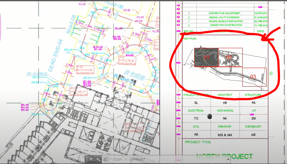

hi
i want to have a keyplan in my plan and profile sheet template like the picture attached.

1q2w3e4rr
thank you for the answer 🙂
but it need an other software. do you know another way to do that?

Setup your template with the hatch per frame on separate layers set frozen default.
after plan sheets are created use VPLAYER to taw per vport

1q2w3e4rr
thank you for your reply
do you know any step by step tutorial to do that?

No. it is acad core command usage
You can freeze and thaw layers independently of view ports
say you have six (6) frames; make 6 layers for the hatch. somethin _keyplan hatch01...._keyplan hatch(n)
create a layer filer for ease of navigating
go to layout make key plan vp active open layer filter scroll to the right until you see the vpfreeze column and select all but the current key plan and choose freeze in that vport
