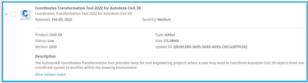

That "cannot transform object" error just means that the Map Tools can't Query Civil 3D Objects like COGO Points, Surfaces, Alignments, etc...
For Civil 3D 2022 there's a new Coordinates Transformation Tool that will transform Civil 3D objects. It's in the Updates section of your account page.
