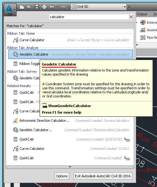

Hi All,
I am trying to convert a point to Latitude and Longitude so I can build a model of an area in Infraworks.
In the Civil 3D file I have selected the local co-ordinate system which is in Malaysia.
In Civil 3d I select the Inquiry Tool, then Points, Point Inverse, then choose Point Co-ordinate 1 (see attached).
I then snap to a point in the drawing but the co-ordinates are not converting to Latitude and Longitude.
I have also attached a reduced version of the Civil 3D file.
Regards
Phil

Phil,
Try the Geodetic Calculator:
Dave

Thanks Dave,
Gave it a try, the co-ordinates are sending me to France when I should be in Malaysia, not sure what is happening.

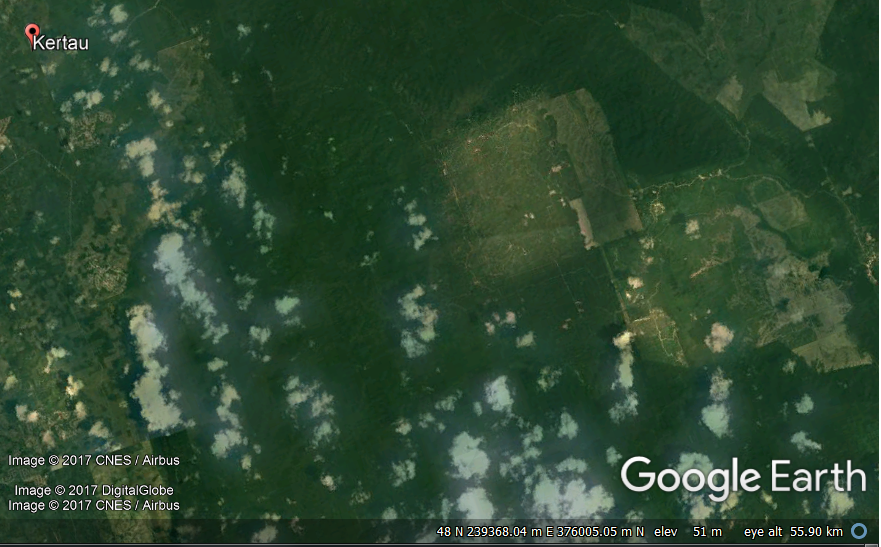

razkaman
i can't open your file cause im using 2017. but i don't think its the right coordinate. if you try with google earth, try find Kertau, Malaysia. and go to tools , select option and change long/lat in 3d view tab , with Universal transerve mercator. and you can see that area is far from your NE.

Thank you Phil. i already take a look, i try to map export that file with various project zone in malaysia, kertau 48N , kertau 47N. then i import it to google earth. and all the shp file is on the ocean near malaysia in different location. i can't use the project zone kertau/malaya and other zone that have kertau in it.
Could it possibly that from the first they import to infraworks/civil 3D , it use incorrect zone?

i also use it , but i can't import shp file with google earth if i use that project zone. but it okay with kertau 48N, 47N. maybe they should change the project zone with 48N. after all Malaysia & Indonesia usually use UTM - WGS84 . and kertau location is based on 48N.
