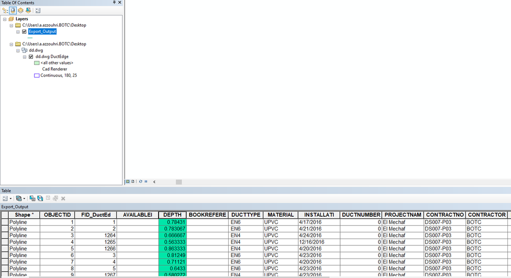

Hi Everyone, I am trying to import a shapefile with a table attribute to cad file that already have almost same table.
I choose the target and the input file as motion the picture, but when I upload the file the target layer still empty.
how can I resolve that issue pleas?

The shown Dialogue from Command: EDA
is not a native AutoCAD or AutoCAD MAP Command. I assume it's a third-party app.
The imported Data from Shapefile are attached as OD (Object Data). Please check the imported information  using
Command: _Properties
Gruß Udo Hübner (CAD-Huebner)

You have a drawing with existing OD table A. You are using MAPIMPORT to import a second shapefile which will have OD table B. Instead of shapefile B populating OD table B, you want shapefile B to populate the existing OD table A.  Correct?
You can Bulk Copy shapefile B a new shapefile C. The bulk copy command will copy the attributes from B to C. During this bulk copy procedure, you can rename the attribute names of shapefile C so they match the attribute names of shapefile A.
Finally, you can perform MAPIMPORT on shapefile C.

I have checked your uploaded files.
ElecSchema_SLD.dwg contains only one AutoCAD point object at 0,0,0 on the "Config" layer.
The DuctEdge.shp https://en.wikipedia.org/wiki/Shapefile
contains 1795 (rectangular) polygons with a table containing various object data.
With MAPIMPORT you can get polylines with attached object data in AutoCAD MAP/Civil 3D.
>> I am trying to import a shapefile with a table attribute to a cad file that already has almost the same table.
Your uploaded DWG does not contain any Block definitions with attributes nor any Object data tables.
Your screenshot shows a customized Blockattribute editor, but you cannot import shape object data as block attributes
directly, if you don't have a point shape but a polygon shape.
Upload a sample CAD file (with blocks with Attributes) that shows correct information when using your custom command EDA. Maybe ist possible to convert the shape information to blocks with attributes using some lisp programming.
What is your intention, what do you finally need?

Your problem does not appear to be in AutoCAD. Your problem does not appear to be in AutoCAD’s MAPIMPORT procedure.
It looks like your problem is in export to shapefile.
Are you using Arc Map? If you are exporting your pipes to shapefile format then you need to export the line work and data correctly.
Chicagolooper
