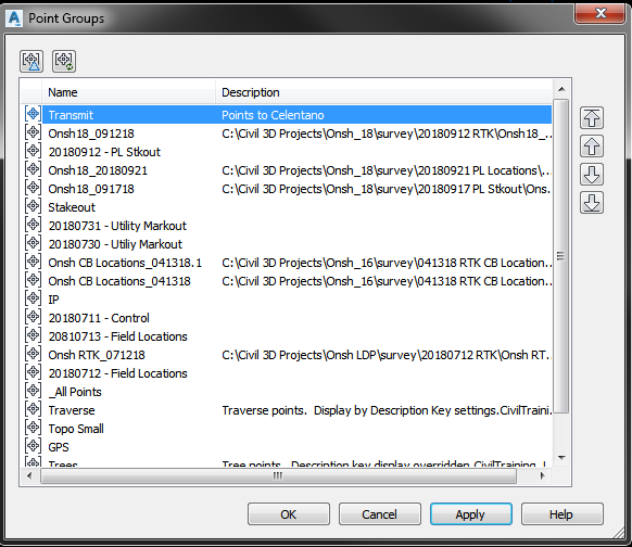

cwr-pae
To populate the columns in the point list either import the points using description keys as @AllenJessup indicates or I the point group window, override tab select the options to override the point and label styles. This will force all points in that point group to use the indicated styles after updating the point group(s). You can right individual point groups to update or update all point groups by right clicking the point group tree heading (or by typing UPDATEALLPOINTGROUPS). Note that if a point is in more than one point group,  settings applied to the points from the point group at the top of the list of point groups overrides settings for point groups below it in the list.
