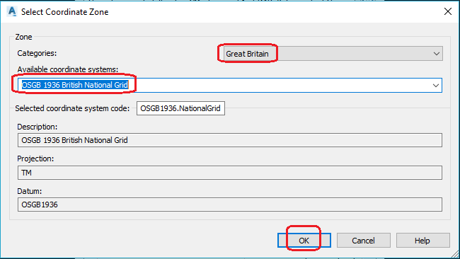

As per the esteemed @tcorey, it can be done but you'll have wait a minute or two for the tin surface to materialize because you have a lot, lots and lots, of data. BTW, you don't have to change the extension, you can leave it as an .asc file.
First you'll need to create a surface in Toolspace. For the definition of that surface, you'll need to add a DEM . You can keep the asc extension as-is (you can change it but it's not mandatory to change ext.). The DEM's CoordSys, however, is blank so you'll have to 'add it' by clicking the ellipsis (see image-1). Choose British Grid for the category and for coordinate systems available select OSGB 1936 British Nat'l Grid (see image-2). When you're done selecting, you'll get this (see image-3). You're Toolspace should look like this (see image-4). The isometric view with Realistic visual style will look like this (see image-5).
1-When you ADD the .acs file, you'll need to enter the CoordSys for the DEM by clicking the ellipsis...1-When you ADD the .acs file, you'll need to enter the CoordSys for the DEM by clicking the ellipsis...2-Choose Great Britain for category and OSGB1936.NationalGrid for the CS.2-Choose Great Britain for category and OSGB1936.NationalGrid for the CS.3-When you see this, you can click OK.3-When you see this, you can click OK.4-Modelspace and Toolspace. The dwg's CS is displayed at the bottom.4-Modelspace and Toolspace. The dwg's CS is displayed at the bottom.5-Isometric view with Realistic visual style.5-Isometric view with Realistic visual style.

hi, thanks for this. this is the method I used initially. see attached dwg. the only thing i can see or import is the dem model boundary.
