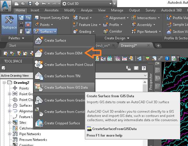

TerryDotson
While it's not my thread to call the shots on, but I think the @Joe-Bouza post on "Surface from GIS Data" is the best solution.  It's direct and straight from file selection to finished result, you don't need to jump through any hoops.

Pointdump
Joe,
I thought I'd try "Create Surface from GIS Data".
First head-scratcher. What means this?
Then I'm assuming(Benny Hill anyone?) because the Column Heading reads "grid_code", a very flat surface is created:

Pointdump
OK, I see now what "Data Mapping" is:
Works pretty good:
