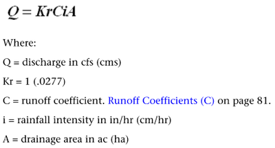

I'm looking for some insight on how Storm Sewers handles the frequency factor (Kr in SS) in the Rational Equation.  Per the user manual, Kr = 1:

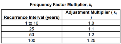

However, some drainage manuals specify that the frequency factor varies based on the storm event:

Kr is not Ki.   Kr is a unit conversion factor.  Its not exposed, so you cant change it.
Ki is a multiplier for rainfall.  It probably would be just as easy simply increase your rainfall values by 10, 20 or 25%.

No just can’t hit the Q like that... because you have to make sure C x Cf <= 1

i.e., it works ok if C < 0.8.   It's a manual validation.
