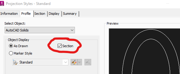

I think you just need to enable Section in the Projection Style under Profile.

Sliced Section or Slice in the Section Tab of style.
