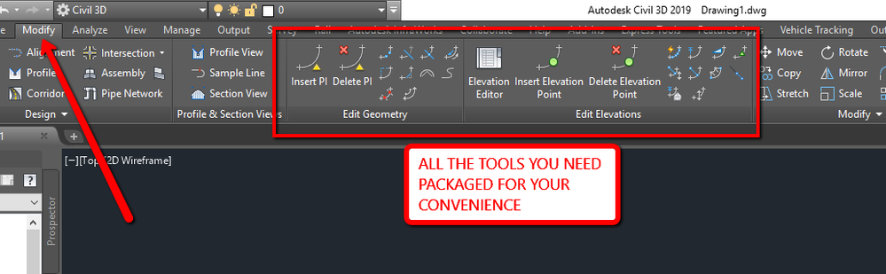

Do you have the ribbons shown? The feature line tools are on the Home ribbon as shown in the image below.

hnguyen7HWBJ
Ms. Mercier,
Yes, I do have the Ribbons shown.
The Civil 3D toolbar-feature-line looks like the attached image below and it contains these icons:

That looks more like an image of a menu and not a toolbar (haven't used toolbars in Civil 3D in ages so I could be wrong). If you want, you can turn on the menu and then you'll have access to the tools there. Set the system variable MENUBAR to 1 and then click on the grading menu and there's two options there, "Edit Feature Line Elevations" and "Edit Feature Line Geometry".
2018-10-04_1542
Like I said, you can turn it on, but why? If you want access to those tools, simply go to the Modify tab on your ribbon. Much faster in my opinion.
2018-10-04_1544

hnguyen7HWBJ
Mr. Brian Hailey,
That what I am looking for.
Thank you very much for showing the detail of the images.
