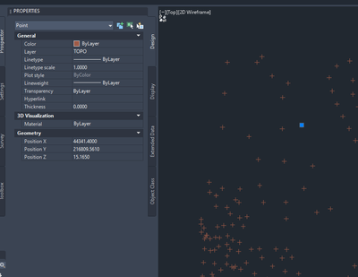

What I'm trying to do here is convert TOPO points in dwg file into a PNEZD text file format, so I can import them into C3D as survey points.
Surveyor sent us a dwg file, I open that file in C3D and it contains TOPO points.
The file should be in Meters but when I open it in C3D it is preset as feet.
However if I open it in Autocad it is fine showing units as Meters.
Back to C3D, without changing anything, it shows Position Z (elevation) of this point is 15.1650, which is the correct value, but in the wrong unit. I would like it to be 15.1650 meters but not 15.1650 feet.
So I change the drawing units from Feet to Meters.
It doesn't affect the existing points on the drawing. It's still 15.1650
Then, I convert this Point into COGO point with the 'Convert Autocad points' button, Easting, Northing and Point elevations all shown in feet now. COGO point elevation is 49.754'.
What's the proper way to convert autocad points into survey points for the use in C3D?
Thank you so much in advance guys.

1) For the first method,
I typed in 'dwgunits' and type in as you said:
Autocad point is now showing the same value, it is still showing in feet and the value has been scaled.

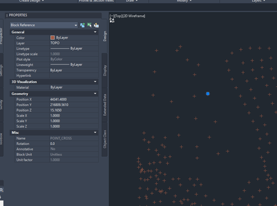

After I convert it to COGO point,
However I can see in drawing setting the unit has been changed to Metre.

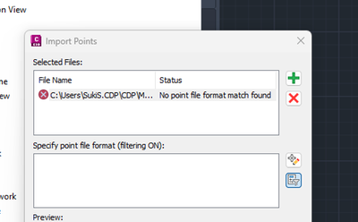

2) For the second method,
I have successfully export all the points to xyz format in .txt file, but I couldn't use import that file back to a new Metre unit drawing, it said 'No point file format match found'.
I followed this link for the instruction:
https://www.thesourcecad.com/data-extraction-autocad/
I typed in 'DATAEXTRACTION',
I export only the autocad points:
And only with the parameter of Position X, Y and Z:
I unchecked 'show count colomn' and 'show name column' so the sheet only contains the information I need.
I exported it into a txt file:
I opened the txt file and it looks like this:
I fixed it up into an xyz comma delimited file format using Word, now it looks like this:
I open a new C3D drawing with Metre as unit, I clicked on 'Import Points', I chose 'ENZ (comma delimited)', Add file,
But it said 'no point file format match found'.

It's still the same value and unitless for my Autocad point,
I convert Autocad point to COGO points, Easting and Northing keeps the value and unit is being changed to meter! (YAYYY), but Point Elevation is still in feet...

Looks like you're really close on this one. Please post your text file. Most likely C3D doesn't like the format. Also, it looks like the first row of your text file has just spaces and needs to be deleted.

@sukishums,
For whatever reason, Civil 3D didn't like that text file. I pasted it into Excel and re-saved it in CSV format. Then it worked.
