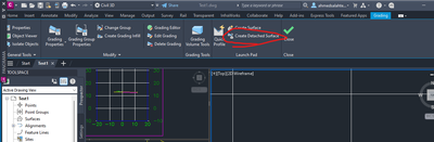

As the title says, I have already built the top surface of my parking lot based in 3D Polylines and apart I do have a Grading Group describing the slopes from the border of the parking lot to the original ground.
How to merge properly?
Can I add the Grading Group to the Surface based on the top of the parking lot? or
I tried to add the 3D Polylines/Feature lines on top to the Surface generated from the Grading Group.  I ended up with a surface with empty spaces/holes.
Let me know if you it is clear enough.

hi @RalphBrown99
what i understood from your post is that you have a TINSurface and you some Gradings and you want to merge em all in one surface, if this is the case try the following,
1- Create Detached Surfaces from the Gradings (check a pic below),
2- Create new empty Surface .
3- paste all TINSurfaces into the new surface (check a pic below).
