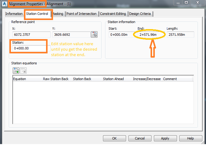

I open the alignment properties and in the station control panel, there is a number about the start and end station of my alignment. however, the number are not able to be edited. how to do that? thanks

Change the beginning in the box Labelled STATION.
Just move the end of the alignment itself to change the end station.

Dear friend,
Follow the image.

In the image in the prior post note the X and Y coordinates of the Reference Point has a button to the right.  Press that button and you can then choose any location along your alignment as a reference point to assign the station listed in the station cell.  You're not locked into setting stationing from the beginning of an alignment. You can choose anywhere along the alignment to apply stationing a reference point.
