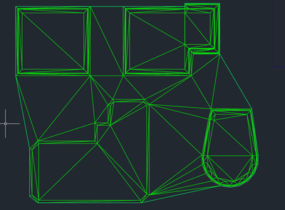

I want to generate a few unconnected "platforms" ( As-Built Area) for my site design, as shown below.
I'm using following the steps here. I define the breaklines that constraints the platform ( platform shapes), and then I add those breaklines to a surface. Then a surface will appear with the platform shapes correctly appear ( defined by the breaklines) with the correct elevation.
The problem is that the unnecessary triangles must also appear in between the triangles due to the nature of Tin Surface, as shown below:
So now I have to manually delete those unwanted triangles which is very tedious.
Is there a better workflow? I just specify the breaklines, the elevations, but there is no need to manually delete the triangles from the surface? Can Grading do the job, if yes, then how?
I attach my files here for your perusal. The original file, and the final file. Note that for the final file, I have a lot of triangles that are not yet deleted so it doesn't fully resemble my final site.

I opened the file but I couldn't see any unnecessary triangles?
Message 3 of 15
soonhui
@will_young , that's exactly my point. Like I said, I only want to generate the surface within the breaklines that I draw, as shown in the following image:
But as you can see, there are a lot of unnecessary triangles that connect between my featurelines/breaklines/platforms, right in the image that you screenshot.

Ah ok, this is how Civil 3d creates the surface, there is no need to delete them. I know it looks wrong at first but it is correct. Some other 3d software can create a mesh with squares but Civil 3d uses triangles.
There are other surface display styles like points or contour lines if you are looking for a different way to represent in a drawing.

CodeDing
@soonhui ,
You need to perform these steps in this order once your full TIN has been created.
1) Add an OUTER Boundary to your first breakline area (either a feature line or polyline, as long as it's closed)
2) Add a SHOW Boundary to your second breakline area (use either closed feature line or polyline)
3) Add a SHOW Boundary to your third breakline area (use either closed feature line or polyline)
4) Add a SHOW Boundary to your fourth breakline area (use either closed feature line or polyline)
I believe this is what you are looking for:
(your top-right area did not have closed line, so triangles are acting bad)
Best,
~DD
Message 10 of 15
AuditInPaperSpace
@soonhui you are right to not want triangles there. TIN surfaces have a boundary feature for a reason! 🙂 Seconding what @CodeDing said; That is the correct answer. Video tutorial here as well, if you prefer videos: https://youtu.be/ff80pNUCFkQ
It looks like some of your boundaries are arcs, so make sure the mid-ordinant distance you set for the boundary is as low as the mid-ordinate distance when you added the feature lines.
Note that there was a bug (they fixed it in C3D 2026) where Add Boundary always selects the bottom-most display order object (no matter what), so if you have a bunch of overlapping objects along your boundary (and not all of them are closed), keep that in mind. Sometimes you'll add a boundary and it will delete half the surface inside the boundary. 😄 If the boundary looks like it's doing what you want, then don't worry about it; You're good.

ChrisRS
Using grading objects would be a good idea here. They can be finicky.
Make sure all of your feature lines are on the same site.
Add a grading group to the site. Be sure to click Create automatic surface.
Add infill gradings to each of the areas.
(Do not add feature lines as break lines.)
A revised file is attached.
You can grade away from the pads with grading objects, but thar gives rounded slopes at the corners. If you are daylighting to an existing or graded surface you can do that with a grading object. The grading object portions are automatically added to the surface.
You can also do this with feature line based corridors.
