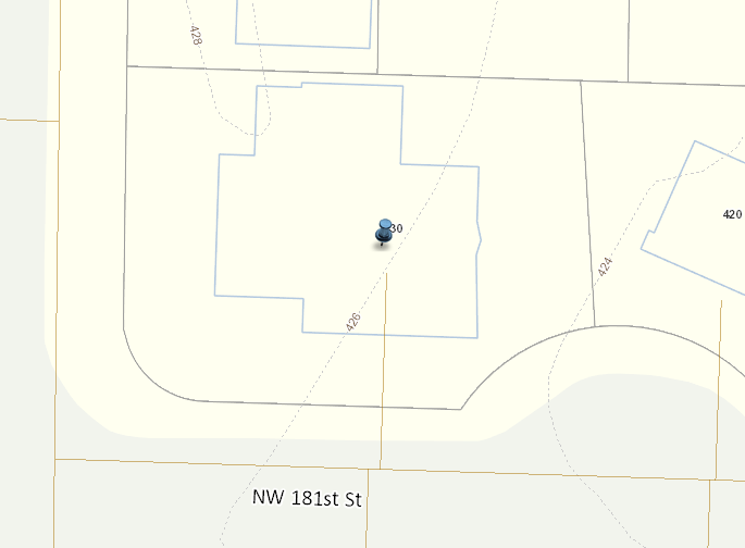

I need to scale this XREF of utilities to the drawing I have. How does one scale a xref to match all of your linework in a drawing.
scale of the site. 23-7869-SEWER AND DRAINAGE.pngScreenshot 2023-07-28 141917.png
