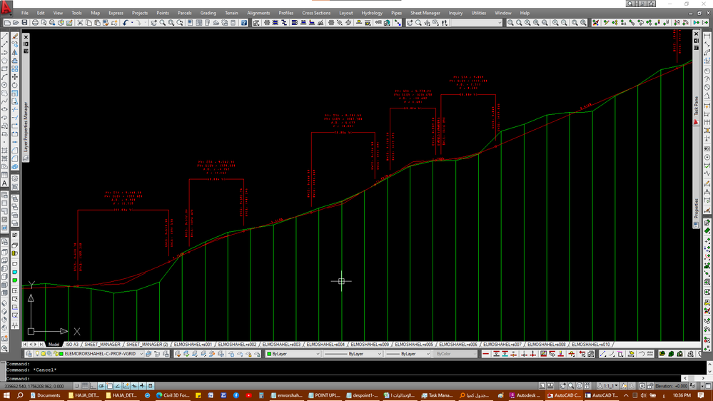

Could I sample profile from section in Civil 3D like land desktop do? the photo from land desktop 2009sample profile from sectionssample profile from sections

My attached photo is a screen shut from land desktop 2009, so that option to do profile existing ground from sections that makes the profile shape is very perfect. So I do not know why Autodesk removes that option from civil 3d?

I want to create existing ground profile for the alignment from section ground center see the photo attached you will remember what I want to do.

this profile made from sectionthis profile made from sectionLook at this profile it is made from section it takes the center ground elevation from every station sample and do it in this profile, it comes very elegant. and there is no for surface miss here.

Have you tried the Create Best Fit Profile command?
You can access it from the ribbon by selecting a profile view and it should be on the Launch Pad Panel of the Profile View context tab of the ribbon, or type the command CreateBestFitProfile.
You can select the surface that you want to use as the source, or other objects.
You will probably have to play with the parameters in the dialogue to get a result you want.

If you want detailed profiles as shown, you can create an alignment and profile view at specific locations. Otherwise you will have to use the XSEC tools.

Are you saying you want to generate the existing surface profile from existing cross sections?
There is a tool called xsect2surf that might be a way to achieve this - it will generate a surface from cross sections, which you can then create a profile from.
You can download a copy here - https://forums.autodesk.com/t5/civil-3d-forum/xsect-2-surf/m-p/5504246/
The 2016 loads and seems to work in Civil 3d 2023. Typing the command xsect2surf brings up the dialogue.

In order to create sections in Civil 3D, you must have either a profile or a surface.
  • There is no need to create a profile from sections created from a profile because you already have a profile.
  • There is no need to create a profile from sections created from a surface because you can just create a surface profile.
There are no other options here so that tool from LDD is useless.

Make the ground from your section points
@e_omairquliey  Not to be disrespectful. but if you made the TIN from the section points and followed civil3d work flows you would have been done a week and an hour ago.
