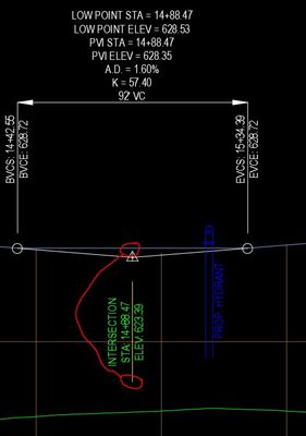

Labels in profile.  I label a few specific items such has centerline crossings, end of pavement, center of cul-de-sac.  These items are not at PVI points, so I label it with a 'Station Elevation' label, and if need be I perform a text override to get the proper name (cul-de-sac, CL 5th St, Center Cul-De-Sac).  The stationing is easy to get, as for elevation I just zoom in and eyeball it.  Problem is when I adjust the profile the label needs to be be manually slid up or down.  Is there a better way to label these points so they are linked to the FG profile?

The only way that I am aware of is THIS.
